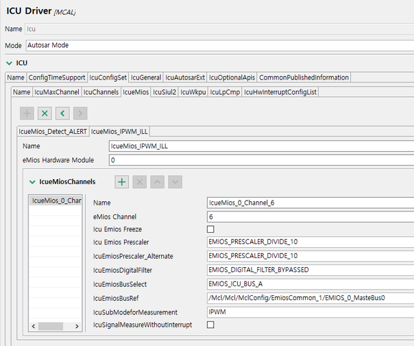

Could you tell me why ActiveTime of IPWM is not understand value.
Below pic is my result when detect PWM signal that are each 1/1000, 250/1000, 500/1000, 750/1000, 999/1000 PWM signal.
Reference code is same as https://community.nxp.com/t5/S32K/S32K344-MCAL-IPWM-ICU-CAPTURE/m-p/1541889 example.
MCU is S32K312 and SDK is PlatformSDK_S32K3_2022_07_S32K312_M7 Ver 2.0.1.
The ration of ActiveTime is not understand each PWM duration.

Hello @dnewbe,
I'm sorry for the delay.
I made some changes in the project, and it works right now, plase find the modified project attached.
The main change was the edge polarity of the EMIOS IPWM channel.
It can't be set in the configuration tool of the ICU driver, so I set it by a direct write to the register in main().
IP_EMIOS_1->CH.UC[1].C |= eMIOS_C_EDPOL(1);
Overflow is an even when the MCL EMIOS_0_MasteBus0 overflows from 65535 to 0.

Could you increase the period of EMIOS_ICU_BUS_A in the MCL driver from the 1 you selected?
So that the counter does not everflow?
Thank you,
3,438件の閲覧回数
dnewbe
Capture image of my setting is below.
The result is not change when each Prescaler and Alternate is DIVIDE_1.
And tell me overflow is what and how do I check ?

danielmartynek
Hello @dnewbe,
