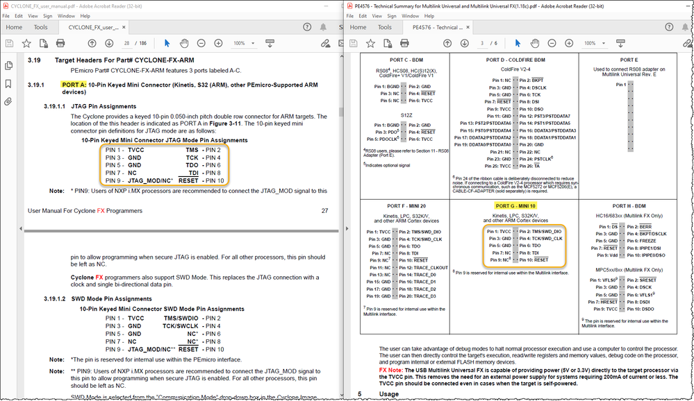

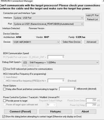

I'm working with MCU S32K148 and I can Debug properly with PE_MultiLink Programmer but when I use Cyclone FX with the same cables (10Pin SWD) It says cant communicate with target.
for both case MCU is get power independently and I haven't use jumper in Cyclone.
What problem can it have.

PORT A of Cyclone FX and PORT G of Multilink look the same.
Have you installed the latest software and drivers for Cyclone FX?
Have you tried using other IDEs, for example, can S32DS be debugged with Cyclone FX?
