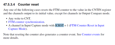

Shaik_meera
So it means on every input capture event  FTM0_COUNT is reset to 0 which is used commonly by FTM0.
There is a register CnSC which is used by each channel and setting ICRST = 0 should not reset the FTM0_COUNT values. And this should allow usage of input capture using same FTM0 instance.
For input capture we will only need a interrupt call on rising/falling edge and I am calculating frequency using LPTMR by measuring the count between two rising edge.
I need a solution to measure input frequency from FTM0 Channel 2 while having PWM output on FTM0 1, 3 and 7.
4,588 Views
Shaik_meera
Please refer this section
which tells that FTM counter reset can be avoided if ICRST = 0. This will limit IC not to measure period between pulses but still can be used for raising/falling/rising & falling edge detection purpose.
4,557 Views
