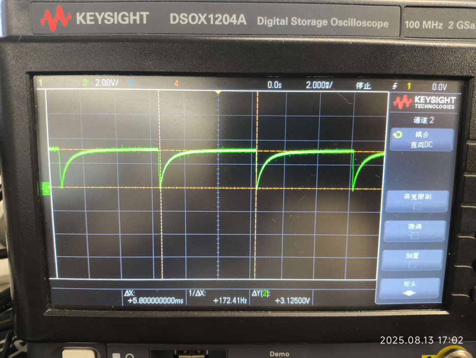

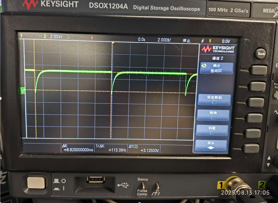

FrankLiu2019
I have captured the waveform of the reset pin using the oscilloscope. The chip is indeed undergoing periodic reset. When I disable the SXOSC, the period is 8 ms. When I enable the SXOSC, the period is 5 ms.Do you have any ideas?second.pngSnipaste_2025-08-13_17-13-58.png
1,522件の閲覧回数
davidtosenovjan
S32K3 have reset escalation feature, what means after certain amount of functional resets, destructive reset is issued and after certain amount of destructive resets, MCU stays in reset to next POR. So if functional reset is periodically issued for whatever reason (watchdog for instance or some misconfiguration of clock or similar reason), it may lead to having MCU in reset because of code executed after POR from internal flash.

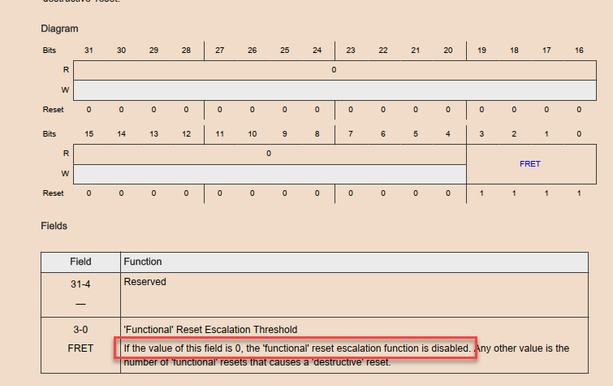

Hi david
What you said is exactly the problem I'm facing.
I tried the method you suggested, but it didn't work. Forget about it for now. Another question I have is whether it's possible to disable this function of the S32K3.?I tried to deactivate it in the S32DS, and it seemed to work. Is this operation correct?
Based on the gPTP demo, I disabled Func_Threshold_Reset and changed MCU_PRECOMPILE_SUPPORT from STD_ON to STD_OFF,Then the code can be run.I still don't know what caused the reset at present.close reset.png
1,459件の閲覧回数
davidtosenovjan
Yes, correct
