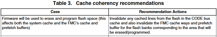

Please clarify how to disable cache for memories for S32K146. What are advandages/disadvantages for disabling cache when write/erase PFLASH, DFLASH .
And i wonder to know  it is necessary to disable cache when write/erase PFLASH, DFLASH .Because i found that if this code existed in my project ,the time of executing every line of code will be slow.when i use IAR compier.
Now , In my project I dont use this code,and it can write and erase PFLASHorDFLASH as usual . Does it OK or these may be a bug?

Hi Kai,
I recommend you to use the newest version of the SDK for the S32K146, S32K1xx RTM SDK v3.0.0.
Please check the following community post (link) to see how to disable the cache. Disabling the cache is not explicitly required but recommended, this is on the user's responsibility. You could refer to AN4745 (link) Optimizing Performance on Kinetis K-series MCUs.
