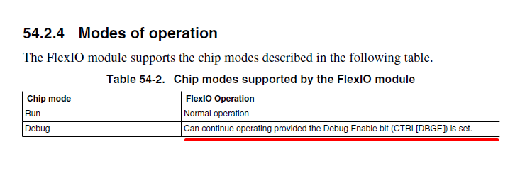

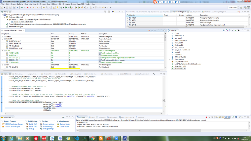

Does it means that flexio can't work in debug mode?
If DGBE is set the FlexIO continues operating even the debug is paused.
54.3.1.4 FlexIO Control Register (CTRL)
I hope it helps.
