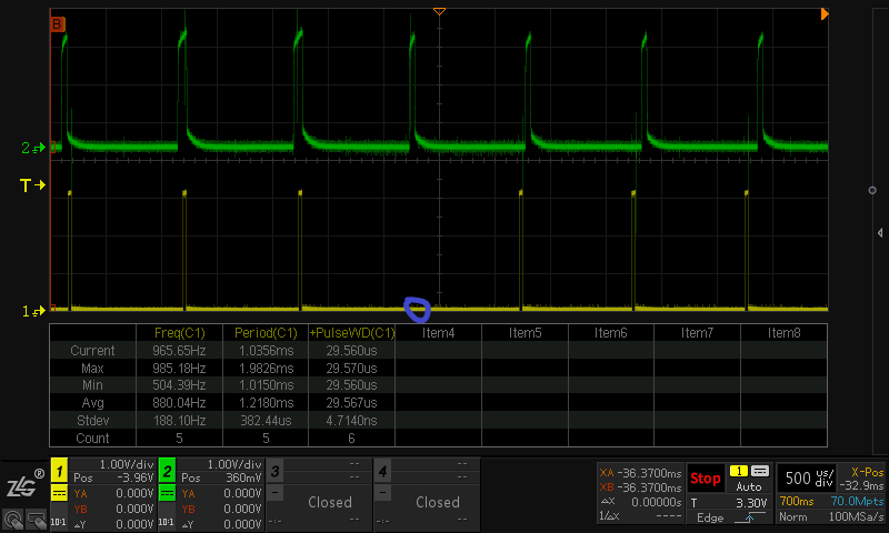

Condition:S32K146 MCAL4.2 ICU Measurement mode. Input signal is 1KHz 5% square wave.
About 70us from Cpsid to Cpsie,about 930us form cpsie to cpsid.
Why does ICU interrupt lost in this case?

danielmartynek
Hello @郑文豪,
When Primask is set, all interrupts become pending - you should see them pending in the NVIC_ISPR registers.
If an interrupt gets lost, it means the interrupt occurred while the interrupt was already pending.
BR, Daniel

Hard to say. There should be only one interrupt in the dual-edge mode once both edges are captured.
And this interrupt becomes pending if it occurs while the interrupts are masked.
Once the interrupt are unmasked, the interrupt routine should be called.
But in the image you posted, the interrupt does not seem to be delayed, it is just missing, as If the FTM flag (or the NVIC flag) got cleared.
Can you poll the NVIC registers while PRIMASK = 1?
BTW, if you want to measure how long the PRIMASK is set, you need to put Dio_WriteChannel(0x24,0); before cpsie i. Because cpsie i enables interrupts, therefore, the DIO write will get deleyed by the ISRs.

郑文豪
Dual-edge mode.
I set port in ICU(FTM) interrupt in the beginning and clear in the endding.
Normally ,the port flip frequence is 1KHz.When interrupt missing ,the frequence is 500Hz.
The yellow line is input signal,the green line is port flip in interrupt.
