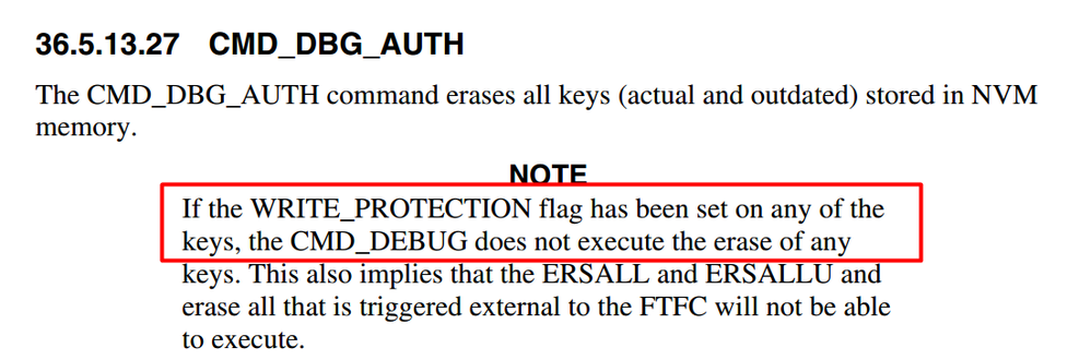

          Today I found a problem ablout S32K146 device security.
          if the WRITE_PROTECTION flag has been set, then Key can't  be erased,  CSEc keys saved in EEPROM backup area, then Erase all Blocks command can't be executed.
so how to remove security to unsecurity except backdoor key method?
and at the same time, debugger can't  remove the security to unsecurity?
wish your help!
