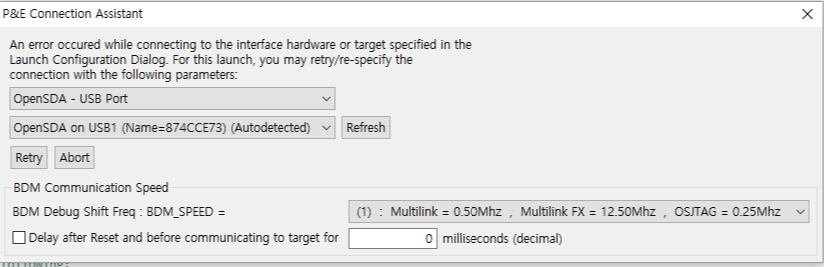

 The board can work normally before call API  FLASH_DRV_EraseBlock(&flashSSDConfig, 16);, and debugging can't work here after call this API。 the status is as following
The following error occurred during development. (D1 Led is On)

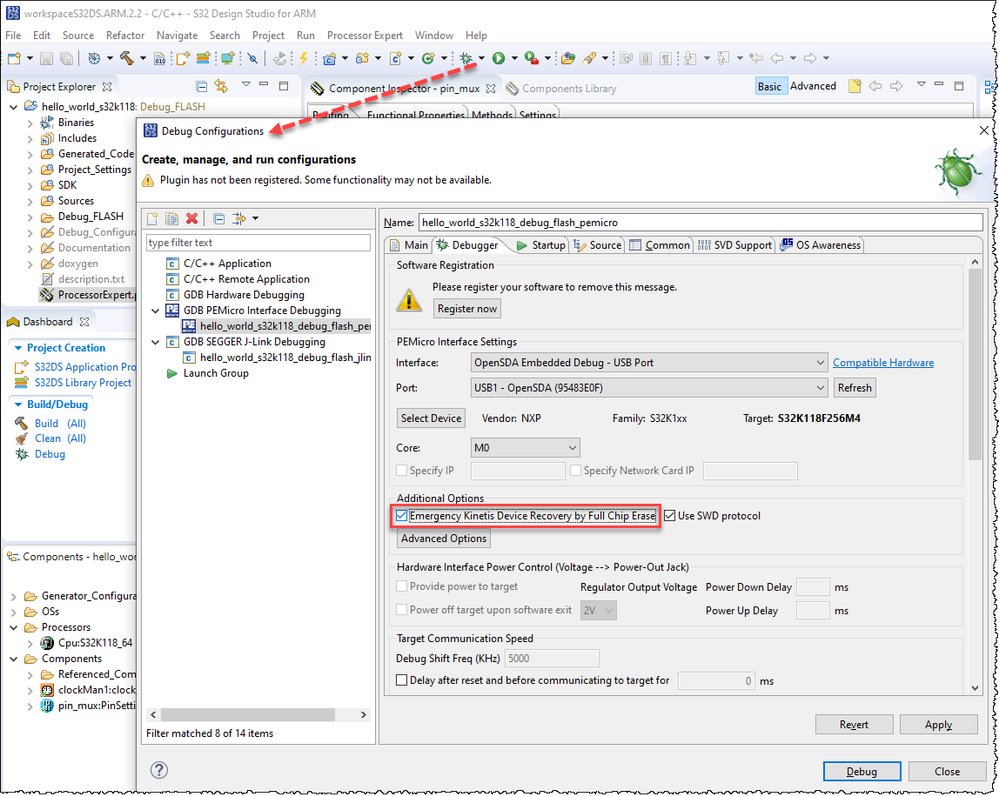

Hi kui,
"Emergency Kinetis Device Recovery by Full Chip Erase" in S32DS debug configuration window may helps.
If still not work, then please try to use the P&E recovery utility mentioned in Bricking and Recovering FRDM-KL25Z Boards: Reset, SWD Clock and Low Power . This tool is able to keep the board halted modem then you can use S32DS program or debug it.

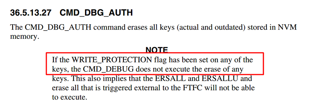

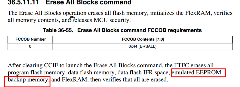

          Today I found a problem ablout S32K146 device security.
          if the WRITE_PROTECTION flag has been set, then Key can't  be erased,  CSEc keys saved in EEPROM backup area, then Erase all Blocks command can't be executed.
so how to remove security to unsecurity except backdoor key method?
and at the same time, debugger can't  remove the security to unsecurity?
wish your help!

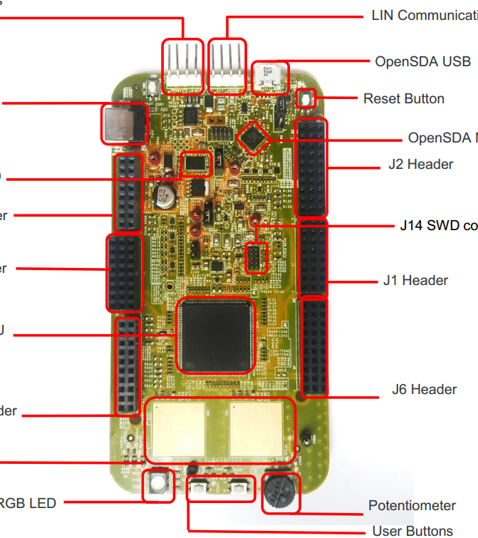

      how to connect S32K146 demo board with J-LINK debugger? my demo board is as above picture.
      thanks for your help
5,533 Views
Robin_Shen
"J14 SWD connector" can be used to connect J-LINK debugger.
