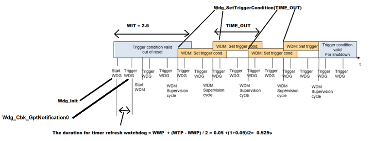

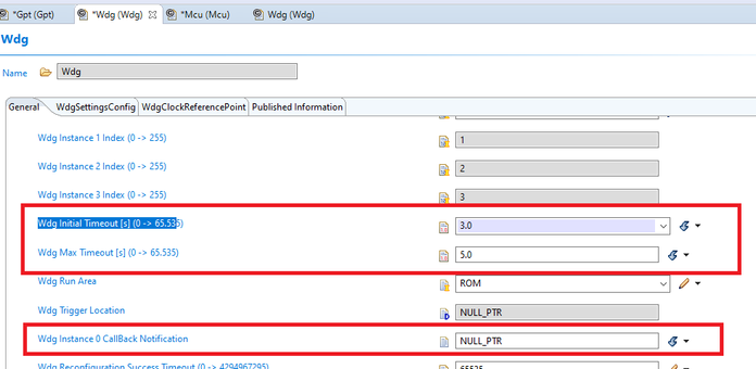

Can you please update this:
Because the period of the slow mode is 1s, so the Initial timeout should be much higher than 0.5 (here I choose 3). Please check the period where you call the Wdg_SetTriggerCondition(TIME_OUT) and also make sure that the TIME_OUT is higher than 0.5 (here I choose 3).
I would like to explain the concept of Wdg driver.
Eg, when user set up the Wdg configuration as below:
- "Wdg Timeout Period" (user will set it in the Wdg 's configuraiton) Eg: WTP = 1s
- "Wdg Window Period" (user will set it in the Wdg 's configuraiton) Eg: WWP = 0.05s
- The duration for timer refresh watchdog(GPT interrupt handler will call the Wdg_Cbk_GptNotification0, the will check the Wdg_timeout and decide to “reset WDOG and reduce the Wdg_timeout” or not ) = WWP + (WTP - WWP) / 2 = 0.05s +(1s +0.05s)/2= 0.525s
- The Wdg_timeout will be set to "Wdg Initial Timeout"(WIT) when the Wdg_init is called (user will set it in the Wdg 's configuraiton) Eg: WIT=2.5s.
With the above configuration the timer will refresh watchdog 4 times (2.5s/0.525s=4) before the watchdog reset MCU.
To make the timer continue refresh the watchdog, application will need to call "Wdg_SetTriggerCondition(TIME_OUT)" to extend the refresh time.
And as the below picture shows the TIME_OUT should be higher than 0.525s (I recommend choosing TIME_OUT is “2 * WTP”).
BR, Daniel

"The duration for timer refresh watchdog(GPT interrupt handler will call the Wdg_Cbk_GptNotification0, the will check the Wdg_timeout and decide to “reset WDOG and reduce the Wdg_timeout” or not" - I checked through my code and didnt find any handler fot Wdg_Cbk_GptNotification0. Can you please explain, how should it look like and what should it do?
7,671件の閲覧回数
danielmartynek
Hello @Kanaqw,
The Wdg_Cbk_GptNotification0 is always set as notification for the GPT channel (which is used for trigger WDG. Please see below picture). Then the WDG driver will start and stop the GPT channel and the timer interrupt handler(in this case, it is FTM interrupt handler) will call the Wdg_Cbk_GptNotification0
