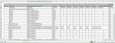

I was exploring the DMAMUX register description , I couldn't found any source list for DMA Channel Source (Slot)
I have gone through all the attached excel sheets , still I was not able to see slot numbers for peripherals
Where can I get those values ???
For example : FlexCAN0 source value is 54

it is within S32K1xx DMA Interrupt Mapping.xlsx.
But this is unfortunately missing in the rev14 of the RM, if have previous version (rev13) please refer to it.

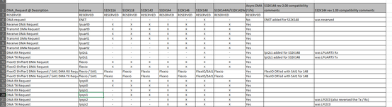

I could download rev13 reference manual , I could able to see the source list of peripherals
but the corresponding equivalent integer number is missing
for example DMA TX Request has instance lpspi1 , but the equivalent number should be 17
but 17 is not visible anywhere (It is placed in row no.20)
Let me know , what I'm missing exactly??

use slider to show most left columns
