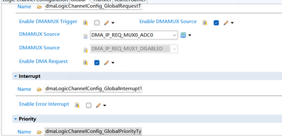

    We are facing a critical issue with the DMA module on the S32K312 development board where the CHn_ES (Channel Error Status) bit is being unexpectedly set, leading to program freezes. Here are the details:
  1. Configuration:
    • Toolchain: EB Tresos (EB 28) for peripheral configuration.

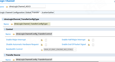

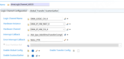

    • ADC Setup: ADC0 and ADC1 configured with ADC_DMA interrupts for data transfer.
    • DMAMUX: Configured in the MCL to route ADC triggers to DMA channels.

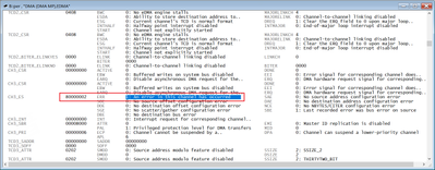

  2. Issue:
    • After initializing the MCL and running the code (see snippet below), the CHn_ES bit asserts immediately, halting the system.
    • The error persists despite correct DMA transfer configurations. Power cycling is required to clear the error. Software reset cannot solve the problem.

4. EB configuration
5.  Read Register

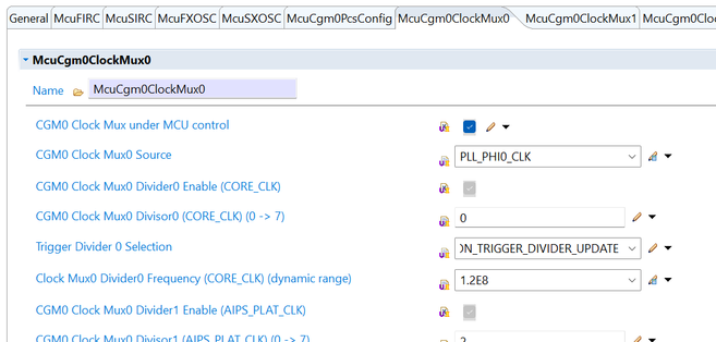

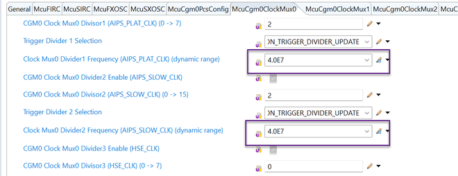

danielmartynek

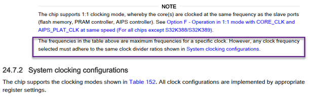

Hi @dongxun,
The clock configuration in the MCU driver is incorrect.
You selected 120MHz for the core:
Which means you have Option B - Reduced Speed mode (CORE_CLK @ 120 MHz) RM rev10, Table 158.
However, both AIPS clocks are set to 40MHz.
It should be set to 60MHz (PLAT) and 30MHz (SLOW).
Otherwise we cannot guarantee the functionality of the MCU, it can behave unpredictable.
The clock configuration does not have to follow the options precisely (Option B, in this case), but the ratios between the clocks must.
在原帖中查看解决方案

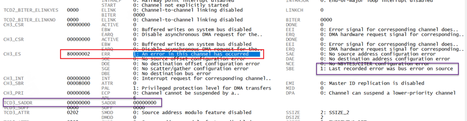

danielmartynek
Hello @dongxun,
I see there is a bus error on the source.
And the source address is not configured:
Double check the DMA configuration in EB tresos.
Can you share the project or the configuration .xdm files?
Which RTD revision do you use?
690 次查看
dongxun
Hi Daniel Martynek,
Thank you for your reply. I've attached the xdm files. We are using RTD version "SW32K3_RTD_4.4_2.0.2_D2211".
I want to mention that this issue is intermittent. Two of my colleagues frequently encounter it, while others do not experience it at all. Personally, the program runs fine in the evening before I leave work, but when I reopen the debugger and upload it in the morning, it goes into ErrorHook. Additionally, the problematic DMA channels are Channel 3 and Channel 4, which are designated for ADC services.
