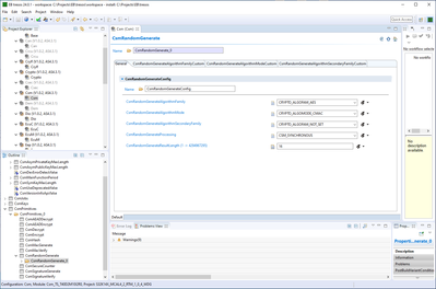

Basically it whats it says in subject, and I dont understand why EB tresos doesnt generate .c or .h file, .epc only. It is how its supposed to be?

Hello @Kanaqw ,
The Csm module is just a stub module(just for compiling project) in the MCAL package. This module will be provide by other company or Third-party(Eg: Elektrobit or Vector,...). So NXP does not provide the code or generation code for this module.
