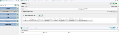

When Using S32 Design Studio 3.3 (S32K144W) and we instance csec and flash driver we got an error which is:
FTFM used in multiple component instances: csec and flash. Is this the expected behavior? I do not find any reference in which we can not used both. I do not know if this is an error in the tool.
Setting FTFC with csec and flash in S32K144 with S32DS2.2 for ARM is perfectly fine
Is this a limitation in the FTFM or is just an error in the tool?
Thanks in advance

It is an error, we are no allowed to generate code
S32 Design Studio for S32 Platform
Version: 3.3
Build id: 200610
Issue: Peripherals: FTFM used in multiple component instances: csec_config_1
Level: Error
Type: Tool problem
Tool: Peripherals
Origin: Peripherals:BOARD_InitPeripherals
Resource: flash_1
Information: Peripherals: FTFM used in multiple component instances: csec_config_1
Issue: Peripherals: FTFM used in multiple component instances: flash_1
Level: Error
Type: Tool problem
Tool: Peripherals
Resource: csec_config_1
Information: Peripherals: FTFM used in multiple component instances: flash_1

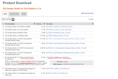

cuongnguyenphu
I tested with version s32sdk_s32k1xx_rtm_402 (4.0.2), this issue is disapeared.
So I suggest you to upgrade to this version to avoid this error
3,269 Views
reymor
Thanks for you answer. How could we update the version?
We do not see any update in extension and update window
3,223 Views
cuongnguyenphu
This RTM 4.0.2 is included in S32 Design Studio 3.4 S32K1XX Service Pack 1.
If you cannot find it, then you can use the offline install package which is available on NXP Flexera:
Go to Software Licensing page >  View accounts > NXP Software > S32 Design Studio IDE > S32 Design Studio for S32 Platform v.3.4 > S32 Design Studio 3.4 S32K1xx Service Pack 1 for offline use
Download and install this package into your current S32DS
