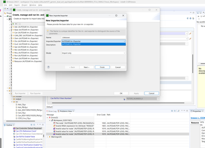

a.) while trying to import a DBC file into the configuration. we don’t get to see the option to import DBC file here:
In addition to understanding the proper procedure for DBC file import—such as compatibility requirements, preprocessing steps, or known limitations within Tresos—we also have concerns regarding licensing constraints. Could there be a possibility that we are missing a required license or that certain features are restricted unless specific licensing conditions are met?

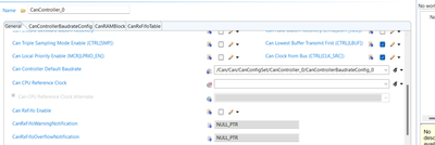

b.) Unable to configure CAN CPU Reference Clock
The peripheral clock selection for FLEXCAN0 appears to be EXT_CLK_OR_CLK_OFF, but when enabled this in MCU module, the reference node does not appear here to configure the CAN CPU reference clock.
Is this expected behavior, or is there a specific configuration or workaround to make the reference node available? Because the generation fails with errors when this is not configured.

a)
You are correct. The evaluation license for Tresos that NXP provides does not contain the license for DBC import. If you need this feature, you will need to contact EB to purchase.

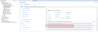

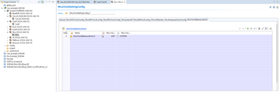

b)
The reference to the CPU clock configuration is set in the MCU driver configuration. MCU plugin needs to be added and then give the reference to it:
