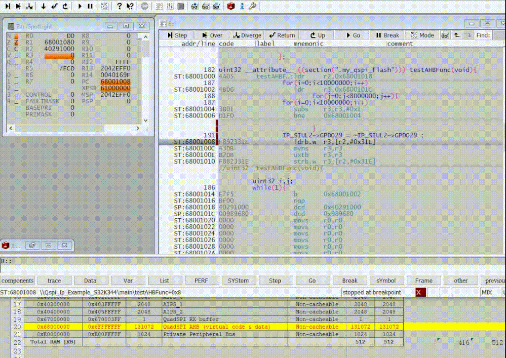

   For code running through AHB on S32K3xx, tested on SCH-47827 and success.
  Steps are as below.
   1. Allocated functions into QuadSPI AHB space.
   2. Program s-recorder of functions in QuadSPI AHB space into QSPI flash on board
   3. Download project which enables AHB reading into S32K3
   4. Run and enjoy the result.
Enjoy it!

    With the example project of 'Qspi_Ip_Example_S32K344' in S32DS_3.4, some changes were implemented into linker_flash_s32k344.ld and main.c, as attachments.
Enjoy it.

Debugging on AHB space
20220728_115506_S32K3_QSPI_AHB_Function_running.gif20220728_115506_S32K3_QSPI_AHB_Function_running.gif
