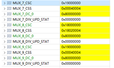

Regarding the clock configuration of the EMAC of S32K3, why is there a timing issue between the input clock and the register configuration?
After TXC and RXC receive stable clocks, configure the relevant registers MUX_7.MUx_8, MUX_9, and the EMAC can work normally.
Before TXC and RXC receive stable clocks, configure the relevant registers MUX_7.MUx_8, MUX_9, and the output rate of the EMAC will be abnormal.
I compared the relevant registers, and all are the same configurations. wuxianlong_0-1761725478471.png

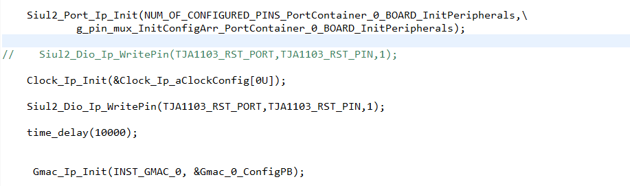

there should be no issue if the clock MUXes (MUX_7, MUX_8, MUX_9) are configured before the external TXC/RXC clocks become stable. However, it is essential to ensure that the EMAC initialization is performed only after the external clocks are stable. This is typically achieved by adding a delay after clock and pin initialization.

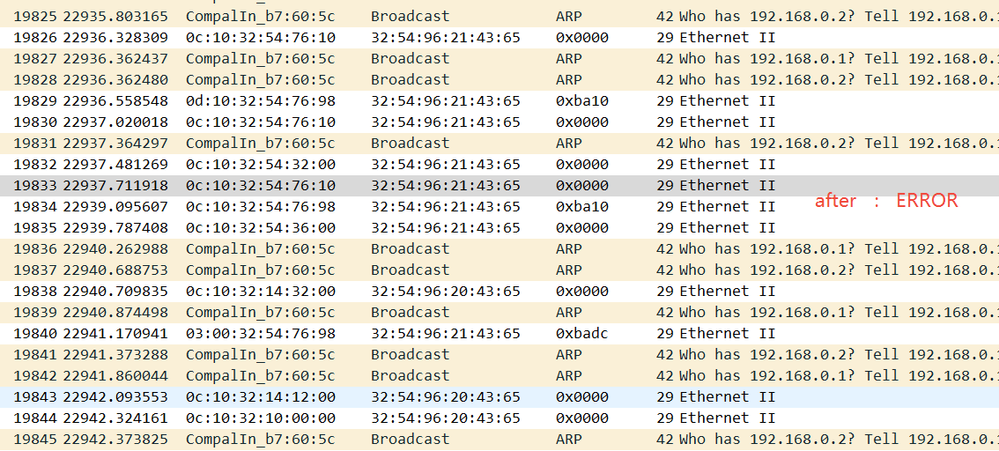

After I tested adding a delay, the EMAC was able to send out MAC frames, but the data was incorrect.
The difference I tested: whether to configure the clock multiplexers (MUX_7, MUX_8, MUX_9) before the external TXC/RXC clock is stable.
Best Regards.

if the issue is related to the placement of PHY RST deassertion—working when done before clock initialization but failing when done after—it could still be due to insufficient delay for PHY activation.
Please note that the PHY typically requires a delay of around 6 ms or more after RST deassertion before it becomes fully active. Try extending the delay you're currently using to ensure proper PHY readiness.
Also, if you deassert RST before clock initialization, you inherently introduce some delay due to waiting for the crystal oscillator, PLL lock, and mode transitions. This might explain why it works in that case.
