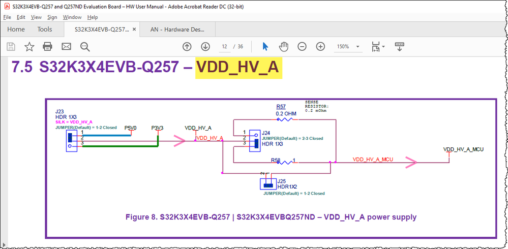

Hello, I want to change the IO voltage of S32K3X4EVB-Q257 development board to 3.3V, what should I do

Hi TZYlss,
Please refer S32K3 MCUs for General Purpose – Hardware Design Package and S32K3X4EVB-Q257 and Q257ND Evaluation Board – HW User Manual
Robin
