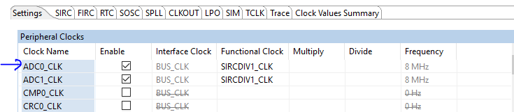

akshaykul89
Hello Daniel,
One quick question in a mean while, "PDB functional clock is SYSCLK" , to confirm this I checked the clock_manager configuration settings in Processor Expert.
Settings->Peripheral Clocks->PDB0_CLK->Interface Clock is set to SYS_CLK in a same way, for ADC0_CLK interface clock is set as BUS_CLK.
Can we possibly change the Interface clock for peripherals ? Or this interface clock is fixed for S32K1XX (S32K144 in my case) peripherals and we have a flexibility just to functional clock based on power mode?  Below is my clock configuration :
It shows PDB0_CLK interface clock as SYS_CLK and no functional clock, can you please share difference between Interface clock and functional clock in this case. I would be helpful.
Any additional inputs on this will be helpful for me. Thank you.

danielmartynek
Hello Akshay,
Please refer to Table 27-9. Peripheral module clocking, RM. rev.9
Interface clock is for the bus interface, if this clock is disbled, any access to the modele triggers a bus fault exception.
ADC functional clock is the clock of the ADC converter.
PDB has only one clock for both the interface and the timer.
