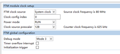

When I use PE to debug the FTM IC peripherals, if I run directly without setting breakpoints, the function is normal. It doesn't work when a breakpoint is set and the program is stopped and then run. Run directly after reset, and the function is restored.
FTM Global config:Debug mode is Mode3;

Hi@1069466534
Can you try seting the debug mode to 0x00?
    FTM_BDM_MODE_00 = 0x00U,    /*!< FTM counter stopped, CH(n)F bit can be set, FTM channels
                                 *   in functional mode, writes to MOD,CNTIN and C(n)V registers bypass
                                 *   the register buffers */
    FTM_BDM_MODE_01 = 0x01U,    /*!< FTM counter stopped, CH(n)F bit is not set, FTM channels
                                 *   outputs are forced to their safe value , writes to MOD,CNTIN and
                                 *   C(n)V registers bypass the register buffers */
    FTM_BDM_MODE_10 = 0x02U,    /*!< FTM counter stopped, CH(n)F bit is not set, FTM channels
                                *    outputs are frozen when chip enters in BDM mode, writes to MOD,
                                *    CNTIN and C(n)V registers bypass the register buffers */
    FTM_BDM_MODE_11 = 0x03U     /*!< FTM counter in functional mode, CH(n)F bit can be set,
                                 *   FTM channels in functional mode, writes to MOD,CNTIN and C(n)V
                                 *   registers is in fully functional mode */

My FTM IC Config
