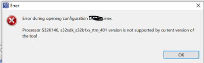

i have a project, the mex file created on S32SDK_S32K1XX_RTM_401, and somehow, the IDE S32DS 3.4 updated the SDK to 4.0.2, and can't find 4.0.1 in S32DS  Extensions and Updates,
so now i can't open the mex file, when clicking the mex file, if popped up:
tried many times, don't know how to open this mex file with S32SDK 4.0.2 .

Hi samcs,
Please refer: HOWTO: Migrate S32K1xx SDK project from SDK v4.0.1 to v4.0.2
