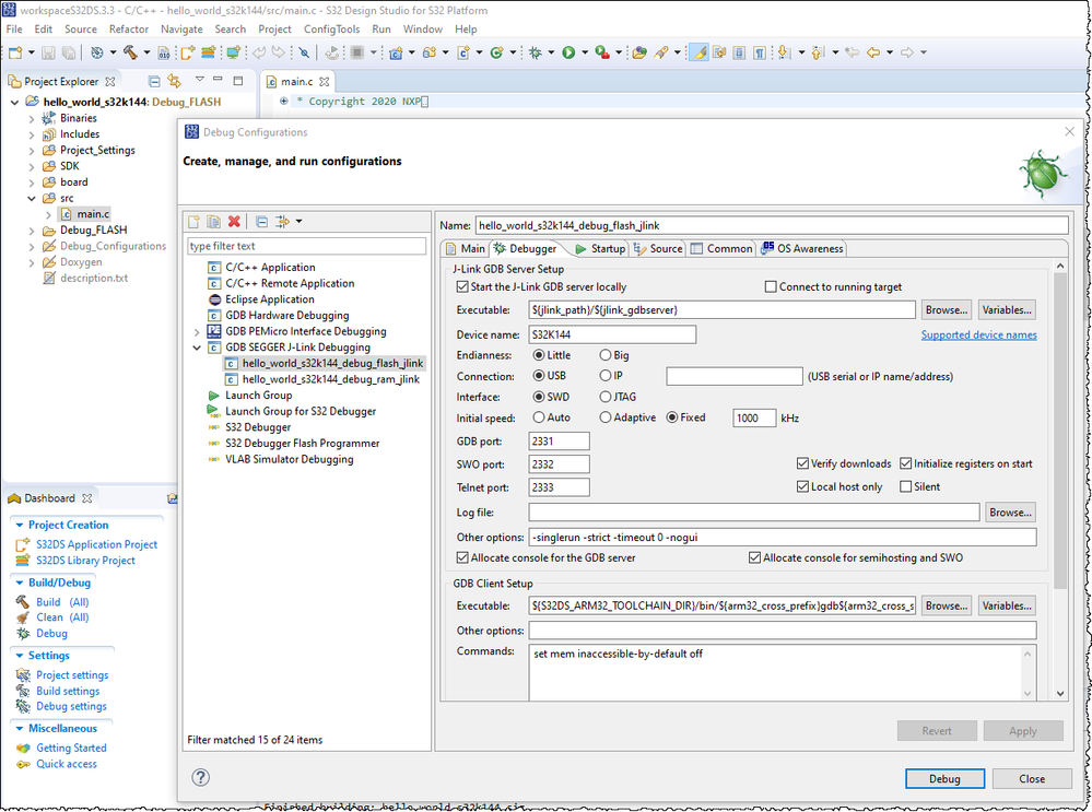

When I using j-link debug s32k144,it is empty in peripheral registers values and peripheral register windows.It is ok in using usb link.

Hi 郑文豪,
If you are using S32DS IDE, please try to use the EmbSys Registers window.

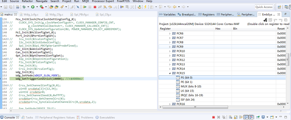

郑文豪
There is no value.

Robin_Shen
Double click on register to read values, after that the register names will shown green.
1,528 Views
郑文豪
Thank you !
