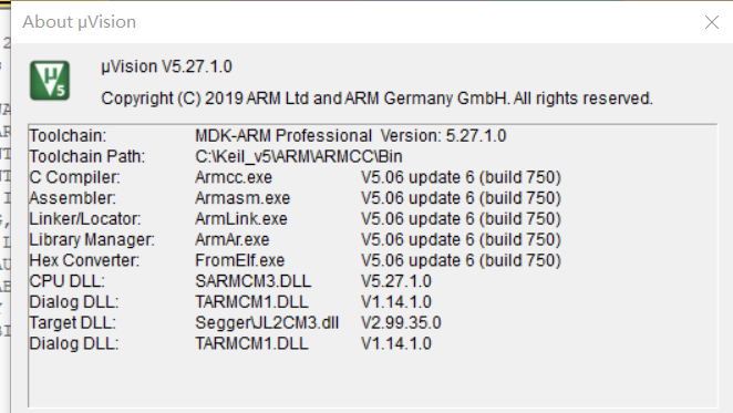

S32K118 in S32DS is to support attach, that is not reset MCU, enter Debug, locate the bug software.
Our products are currently developed with Keil, and now found that Keil can not debug without resetting S32K118, so we want to ask whether Keil support not resetting S32K118 debugging? And how to do it.

Please refer: µVISION DEBUGGER: Connect to a running Target without Hardware Reset
What kind of debugger are you using? Have you try to use other debugger?

keil version:μVision V5.27.1.0;The debugger is Jlink.
This method has been tested and will reset when the debugger is connected.
