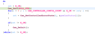

i met an issue of Can_Init on my S32K344 ecu.
the RTD is 2.0 ,but the code of FlexCAN_EnterFreezeMode is the same as the one in RTD 6.0
the issue is, the FRZACK bit can not be 1 when FRZ and HALT became 1, which lead to the can_init call failed.
the problem is very simple to reissue by following the next steps:
1. in normal commication state, sending 3 canfd frames(64 bytes) to the ecu every 5ms using the tester and there is no other can node on the can bus;
2.reset the ecu by calling Mcu_PerformReset. do not stop the canfd fames, due to the reset process makes the s32k3 CANnode disabled, the can tester will rise can error  frame, which makes the can tester re-send the frames in very high frequecy.
3.when the mcu reset, it executes the Can_Init process, at this time, the can bus is very likely in the busy state, which may lead the Can_Init failed.
4.repeat 1~3 until the Can_Init call is in fail.
5.if failed, re-calling Can_Init can not work withou reset
6.if failed, stop sending the canfd frames, and the re-calling Can_Init can not work withou reset either;

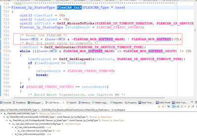

thanks for your help. i use MCR.SOFTRST to reset can before calling Can_Init and it works. I think it is better to add the operation in the RTD code

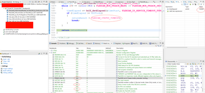

i made a mistake, the transciever is NXP TJA 1145. the TJA1145 can not enter offline mode when the  CAN bus is busy, so the config was not work, the transceiver is in operation mode still.
i have tested for about ten thousand times for reset without canfd frames reception, the ECU can work normally and can_init performs as expected.
the can soft reset operation by SOFTRST bit  is done in FlexCan_Init, this does nothing for the issue.

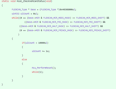

i tried to call mcu_performreset when can_init failed and test reset with canfd frames reception for ten thousand times, the ECU can work normally.
based on the information above, i could confirm that the issue is cause by can frame reception during can_init.
