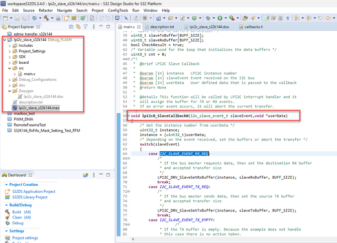

Hello NXP Team,
I am using the S32K144 microcontroller. I am working with I2C and would like to receive data using interrupts. Is this possible?
Thank you!
#S32K1
269 Views
Senlent
Hi@adem_marangoz
The following demonstration can be found in S32 DS.

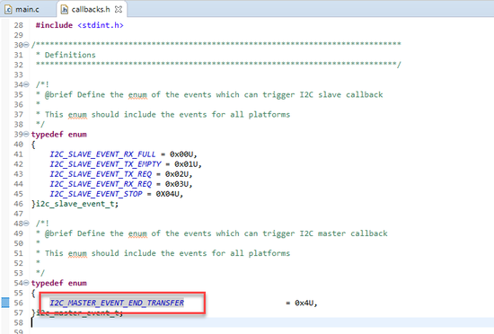

adem_marangoz
But my I2C settings are as a master.
239 Views
Senlent
Hi@adem_marangoz
The Master transfer provides an interrupt callback function, but it only triggers an interrupt after the transfer is completed, nothing more.
