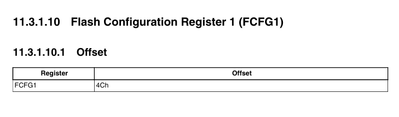

So, if we want to check the flash memory configuration via Flash Configuration Register 1 in SIM Module, EEERAMSIZE should be set to 0 bytes( 0x1111) and DEPART bits value is set to default value( 0x1111).
But when i erase the keys and see the register value of FCFG1, EEERAM size is still 0x02 meaning 4KB. Why is it so??

If you have brand new device or if you have a device where you just erased the keys, the state of DEPART bits is 0b1111 (notice that DEPART is updated after reset, not immediately after key erase) and state of EEESIZE is 0b0010.
So, if DEPART is 0b1111, the manual says: "Default value. FlexNVM not configured with a valid DEPART code"
EEESIZE is not important in this case.
Even if Emulated EEPROM is not used and user wants to use FlexNVM as normal data flash and FlexRAM is normal RAM, it's mandatory to run partition command anyway. After partitioning, both EEESIZE and DEPART will contain correct/expected values.
To check if the device is partitioned or not, read the DEPART only (DEPART = 0b1111 -> not partitioned).
