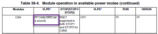

The VLPR mode is a RUN mode not a STOP mode.

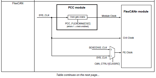

And the FlexCAN module is fully functional in this mode.
However, in VLPR, the max SYS_CLK frequency is 4MHz.

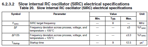

Please note that the SIRC clock is not very precise:

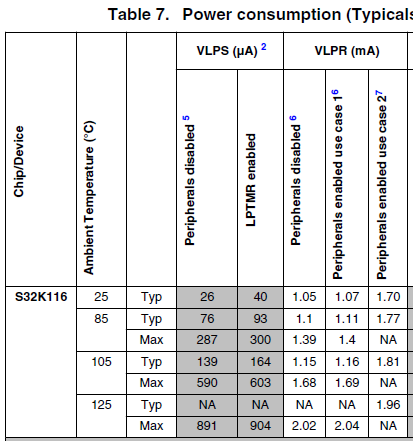

Also, the specified consumption of S32K116 in VLPR is >1mA.
Please refer to the S32K1xx_Power_Modes_Configuration.xlsx file attached to the datasheet for information about use cases.
