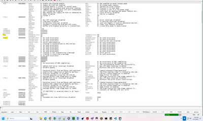

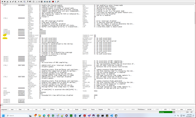

Venu_M
Hi Petr,
We observed that on a successful transmission register values and CAN stopping time.
successful transmission:
CAN stopping time:
Below I'm attaching the whole register dump of CAN also, it will help to narrow down the issue.

PetrS
thanks for some info, but check as well MB are is some MB is prepared for transmission.
From given register dump I only see for stop time case a module is receiving a message. This could be normal condition, or maybe bus is held dominant somehow. Not sure if analyzer can do it, but you wrote restarting analyzer the MCU transmission is restored. You can try to measure bus signals as well as TXD/RXD lines to find more for this stuck condition.
