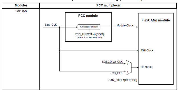

Senlent
Hi@chai_997128
I don't quiet understand, how you can set the PE clock to 5MHz? It's totally unreasonable.

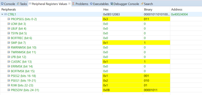

chai_997128

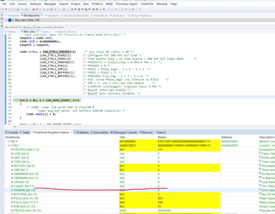

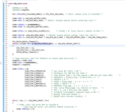

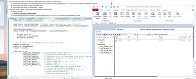

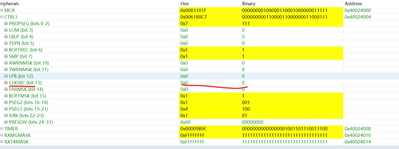

chai_997128_0-1687763111320.pngchai_997128_0-1687763111320.pngchai_997128_1-1687763247973.pngchai_997128_1-1687763247973.png
Hi @Senlent When debugging this configuration, CTRL ->CLKSRC cannot be set to 1, but it can be set during single step operation.What could be the reason for this?

Senlent
Hi@chai_997128
from the code your provided, there is something wrong here.

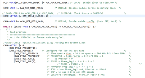

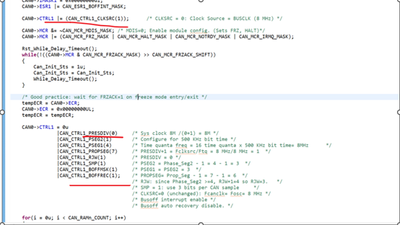

chai_997128
 Hi @Senlent I updated the CAN initialization code to this before updating the CAN_ CTRL1_ CLKSRC set. Why is this? Is it related to project engineering?
8,386件の閲覧回数
Senlent
Hi@chai_997128
Have you carefully read the test demo and results I gave you? Is there such a problem here? It doesn't!

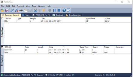

chai_997128
The system clock is 60M
CAN can operate without frequency division using a peripheral clock
Can runs normally.

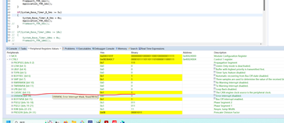

chai_997128_0-1687848034999.pngchai_997128_0-1687848034999.pngchai_997128_1-1687848040718.pngchai_997128_1-1687848040718.png
2、
60M, without frequency division
Unable to run correctly when propagation segment is 5, synchronization segment 1 is 3, and synchronization segment 2 is 1
Hi @Senlent There are two phenomena, but the settings of the propagation segment and the synchronization segment are different. One can run normally and the other cannot. Why? I don't understand. Can you explain this phenomenon?Thanks!

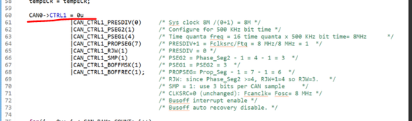

Senlent
Hi@chai_997128
The picture is not clear. Second, I see that you haven't set CTRL->CLKSRC to 1.
Don't you see any difference between these two places?
CAN0->CTRL1=0u | xx........
CAN0->CTRL1 |=0u | xx.........

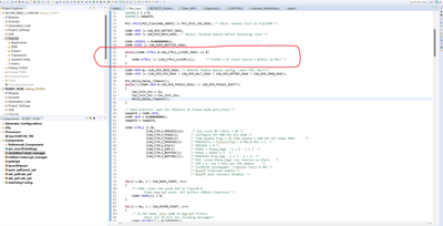

chai_997128
I have seen the results of your presentation, and I am still looking at the reasons for my own phenomenon. thanks!
8,428件の閲覧回数
chai_997128
Hi @Senlent This value cannot still be set to 1, which is a strange phenomenon. All other codes are annotated, only setting CAN_ CTRL1_ CLKSRC, unable to set, running this CAN in one step_ CTRL1. The CLKSRC value can be set.

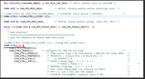

chai_997128
I did not use the SDK configuration and posted it: the system clock is configured to 60M
CAN0->CTRL1 |=(CAN_CTRL1_CLKSRC (1)); Using the system clock
CAN0->CTRL1=0u
|CAN_ CTRL1_ PRESDIV (11)/* Sys clock 5M/(11+1)=5M*/
|CAN_ CTRL1_ PSEG2 (1)/* Configure for 500 KHz bit time*/
|CAN_ CTRL1_ PSEG1 (2)/* Time quanta freq=10 time quanta x 500 KHz bit time=5MHz*/
|CAN_ CTRL1_ PROPSEG (3)/* PRESDIV+1=Fclksrc/Ftq=5 MHz/5 MHz=1*/
|CAN_ CTRL1_ RJW (1)/* PRESDIV=0*/
|CAN_ CTRL1_ SMP (1)/* PSEG2=Phase_ Seg2-1=4-1=3*/
|CAN_ CTRL1_ BOFFMSK (1)/* PSEG1=PSEG2=3*/
|CAN_ CTRL1_ BOFFREC (1); /*PROPSEG=Prop_ Seg-1=7-1=6 */* RJW: since Phase_ Seg2>=4, RJW+1=4 so RJW=3 */
/*SMP=1: use 3 bits per CAN sample*/
/*CLKsrc=0 (unchanged): Fcanclk=Fosc=8 MHz*/
/*Busoff interrupt enable*/
/*Busoff auto recovery disabled*/
I want to obtain a configuration with a sampling point of 80%.

Senlent
Hi@chai_997128
as your configuration,500kbps,80%,PE clock is 60MHz,works fine on myside.
please check CTRL->CLKSRC is set to 1 or not
