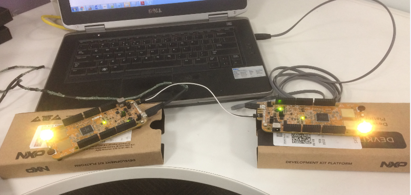

I am testing CAN Master and CAN slave on two different S32K144 EVB.
It seems transmit and receive is not working.
Test Setup:
Below picture shows the test setup.
I have connected two different S32K144 EVB's to two PC and running separate master,slave debug sessions.
Please guide me the exact steps to test CAN_MASTER and CAN_SLAVE sample examples with pictures if possible.
Awaiting for the response.
Mohan

This example needs a 12V power supply in order to work properly. Please see the example documentation.

What is the expected Ampere ? whether 2 Ampere is OK ?
1,860 Views
AnaAldescu
Yes, 2A should be OK.
