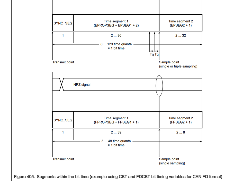

3) if I want to configure bit timing for the nominal phase when the following are enabled for CAN FD.
according to the RM i should follow the image below, right ?
4) when configuring  , which value do i  need to put , do i need to put the value for PSEG1 , FPSEG2 etc or the value of Time segments 1 and 2 ? Time quanta is it =  Time segment 1 + Time segment 2 ?
1,211 Views
Julián_AragónM
Hi @Ayaz,
1) PE Clock refers to CANCLK.
2) Before Tq.
3) & 4) Please refer to
for bit timing calculation.
Julián
