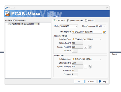

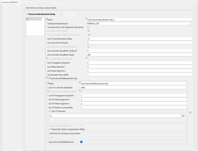

I am trying to run send CAN FD frames using S32K344 + TJA1145A, and receive using PCAN View, I do receive 8 byte frames but not when I change it to 64 bytes.
Any guidance on what and how to configure it for 500kbps arbitration and 2Mbps CAN baudrate, would be really helpful. My PCAN View and NXP FlexCAN baudrate settings are as follows:

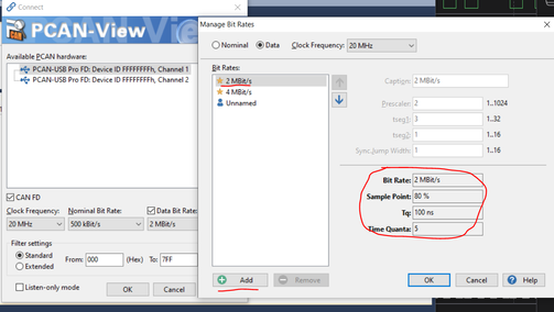

Hi@psarkar
below is my setting, you can refer to it.

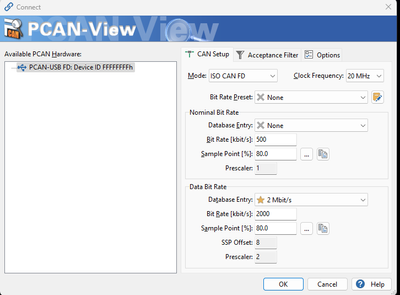

psarkar
I do not see a field to enter time quanta in PCAN View

Senlent
Hi@psarkar
If you are using our EVB, you can test this demo.
Although we are using different PCAN tools, based on your current configuration, i think you should be able to receive data from EVB.
