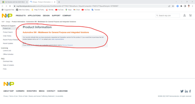

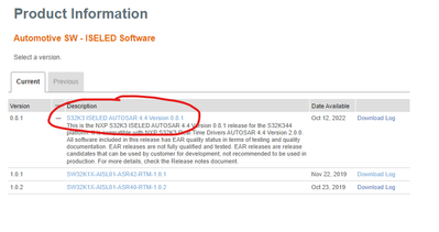

I try to install S32 SDK ISELED driver but I can only download the version as picture bellow.
Can I ask you one question that which version of S32 SDK ISELED driver you use.

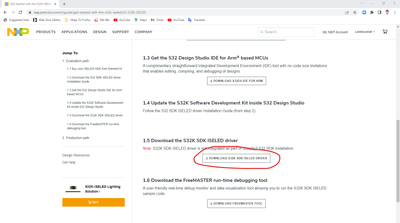

nanjun
could you follow the 1.5 section to download it? The driver is too large to upload.
https://www.nxp.com/document/guide/get-started-with-the-s32k-iseled:GS-S32K-ISELED
The guide can be found here:
https://www.nxp.com/docs/en/user-guide/S32KSDKISELEDRTMUG.pdf

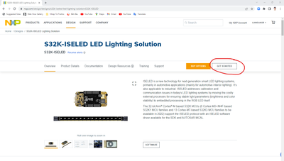

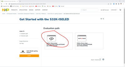

toxuandung
Hi nanjun,
Please have look at the pictures bellow. Actually I already try many time to follow the guide from NXP but I still not able to download the driver. Can you please help to send me by wetransfer.
Thanks you so much for the strong support. I am stuck with my project now.
