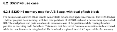

lukaszadrapa
Hi Christof,
"Placing the bootloader at the NVM disables it capabilities to write to an emulated EEPROM.
On the other hand, placing it in NVM enables us to use the whole P-Flash capacity.
Which one is the best way to implement this function?"
If you want to use S32K148, you can have both advantages at the same time.
The application note talks about S32K146 in case of A/B swap:
 S32K148 has even more flash.
So, first two blocks can be used for applications and the Program part of the shared block for bootloader and FlexNVM part can be still used for EEPROM.
Lukas

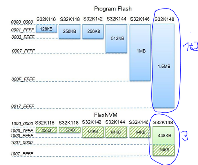

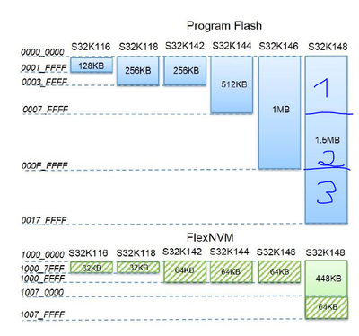

christofhaiding
Hi Lukas!
Thx for the answer
Am sry for asking again.
If you mean the sectioning of 1+2+3 you don't mean it this way:
That was exactly the problem we encountered, because we set the Bootloader to the FlexNVM (0x1000 0000) and could not have an writting access to the emulated EEPROM.
You suggest that the partitioning should be this way?
With part 1+2 as holder for the application and part 3 as holder for the bootloader?
Thanks for the tip with locating the source to the RAM section.
Wie will try this.
Christof

lukaszadrapa
That's a good question. I'm sorry, I can see that my previous answer is inaccurate. I was talking about mix of S32K146 and S32K148.
In case of S32K148, it makes sense to to have 3 partitions in program flash (bootloader + app1 + app2) as on your second screenshot and last 512KB block can be used for Emulated EEPROM + normal data flash storage if needed.
This is the most straightforward solution, I think. The only disadvatange is that you will have one 512KB block dedicated only for bootloader which is usually small.
If you need more memory for applications, it would be necessary to use also block with the bootloader and 448KB block. It's doable too, but more complicated.
