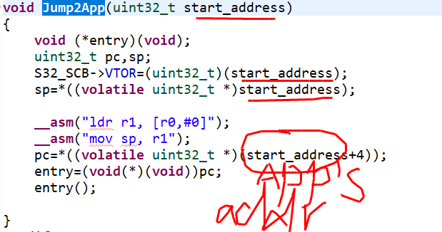

Bootloader can download the program to Flash, but the program is not started.What's the problem?Who can help me?Thank you very much.Bootloader is migrated from the S32 SDK demo.

there's no problem with the linker files.
Did you disable all interrupts before jump to user application? It's necessary to disable all interrupts globally and also disable all local enable bits. It's also good practice to put everything to default state before jump.
When you step the code, where does it fail exactly?

zhaowei961
yes,I put everything into default state.finally I found when jumps to App,PC address has some problem.Now,it works.Thank you very much.

zhaowei961
I'm sorry.So later to reply.My code is as follows.I hope it can help you.1.png
If still have problem,tell me .
