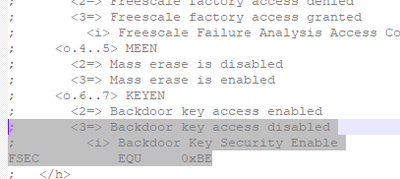

Thanks for the code, I was trying to set the Backdoor access key by modifying steps in startup_S32K116.s file as below to set FSEC register:
BackDoorK0 EQU 0x10
BackDoorK1 EQU 0x32
BackDoorK2 EQU 0x54
BackDoorK3 EQU 0x76
BackDoorK4 EQU 0x98
BackDoorK5 EQU 0xBA
BackDoorK6 EQU 0xDC
BackDoorK7 EQU 0xFE
; <3=> Backdoor key access disabled
; <i> Backdoor Key Security Enable
FSEC EQU 0xBE

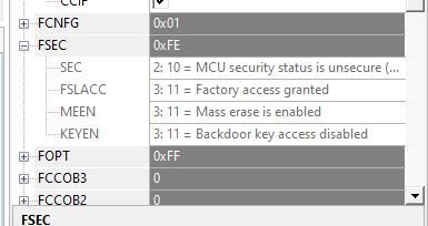

But not able to see BF value in the debugger. Can you please support me in this regards.

I am using KEIL IDE. On 0x00value I am having is in the figure below also sharing my startup_S32K116.s file used by me. Not able to see BF value in the debugger. Can you please support me in this regards

Hello @prabhatg44,
The linker file seems to be correct but it looks like it hasn't been loaded to the MCU.
Unfortunately, we don't use KEIL so I can't test it.
I would recommend contacting KEIL support.

Hi @prabhatg44,
I'm not familiar with this version of startup_S32K116.S, what IDE do you use?
Can you check the memory at 0x400?
