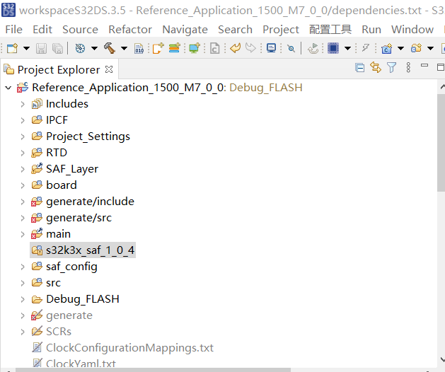

Then , I found that there is no file in the folder s32k_saf_1_0_4
Is there any problem?

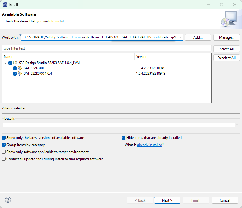

Did you install S32K3_SAF_1.0.4_EVAL_DS_updatesite.zip? (BESS\BESS_2024_06\Safety_Software_Framework_Demo_1_0_4\S32K3_SAF_1.0.4_EVAL_DS_updatesite.zip)

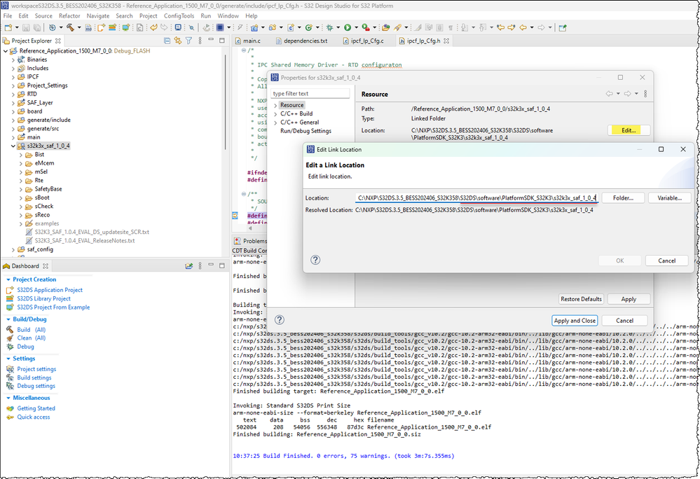

After the installation is complete, you need to modify the Location:

Robin_Shen

Hi Robin
Thanks a lot
It turns out that I didn't change the location of this folder.
Now it's all right
