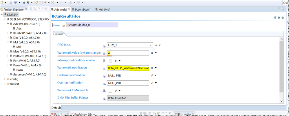

2. I see that you set the Watermark value to 4. Does the total time for the four conversions calculated based on your CORE_CLK frequency and ADC configuration match the measured results?

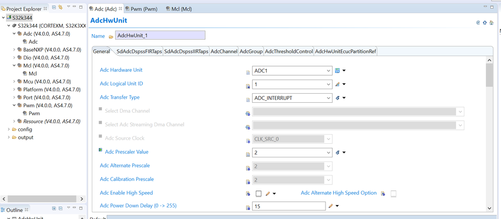

I see that you set the Adc Prescaler Value to 2, so the ADC controller clock is equal to half of the module clock
