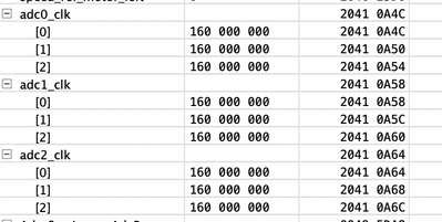

So i checked the ADC<0,1,2>_CLK before the system_clock config runs, after the adc_init is called and after calibration.
adc0_clk[0] = Clock_Ip_GetClockFrequency(ADC0_CLK);
adc1_clk[0] = Clock_Ip_GetClockFrequency(ADC1_CLK);

adc0_clk[2] = Clock_Ip_GetClockFrequency(ADC0_CLK);
adc1_clk[2] = Clock_Ip_GetClockFrequency(ADC1_CLK);
adc2_clk[2] = Clock_Ip_GetClockFrequency(ADC2_CLK);
and i'm seeing 160,000,000 for all of them.
Screenshot 2024-11-08 at 9.08.15 AM.pngScreenshot 2024-11-08 at 9.08.15 AM.png
Screenshot 2024-11-08 at 9.07.16 AM.pngScreenshot 2024-11-08 at 9.07.16 AM.png

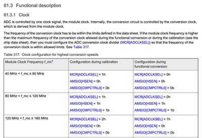

next i checked MCR and AMSIO to check that they match what is described in table 317 in the reference manual.
Screenshot 2024-11-08 at 9.09.25 AM.pngScreenshot 2024-11-08 at 9.09.25 AM.png
Screenshot 2024-11-08 at 9.09.47 AM.pngScreenshot 2024-11-08 at 9.09.47 AM.png
MCR[ADCLKSEL] is set to 1 which seems correct. meaning that the ADC_CLK is 80mhz.
AMSIO[HSEN] is set to 2. that doesn’t seem right. it should be set to 0.
AMSIO[CMPCTRL0] is set to 0.
Is this a bug in the ADC_HW access function then?

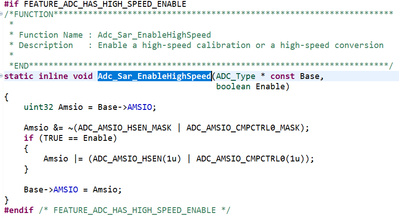

Adc_Sar_Ip_StatusType Adc_Sar_Ip_SetClockMode(const uint32 u32Instance,
                                              const Adc_Sar_Ip_ClockConfigType * const pConfig)
#if FEATURE_ADC_HAS_HIGH_SPEED_ENABLE
            SchM_Enter_Adc_ADC_EXCLUSIVE_AREA_51();
            /* Enables high speed conversion or calibration */
            Adc_Sar_EnableHighSpeed(AdcBasePtr, pConfig->HighSpeedConvEn);
            SchM_Exit_Adc_ADC_EXCLUSIVE_AREA_51();
#endif /* FEATURE_ADC_HAS_HIGH_SPEED_ENABLE */
/*FUNCTION*********************************************************************
 * Function Name : Adc_Sar_EnableHighSpeed
 * Description   : Enable a high-speed calibration or a high-speed conversion
 *END*************************************************************************/
static inline void Adc_Sar_EnableHighSpeed(ADC_Type * const Base,
                                           boolean Enable)
    uint32 Amsio = Base->AMSIO;
    Amsio &= ~(ADC_AMSIO_HSEN_MASK);
    Amsio |= ADC_AMSIO_HSEN(Enable ? 3u : 0u);
    Base->AMSIO = Amsio;
If EnableHighSpeed is set to true. this function writes 3 to HSEN. but setting HSEN to 3 does not seem to be a valid option as describe in the table. it should instead be writing 1 to HSEN and 1 to CMPCTRL0. but that is not what this function is doing.
but regardless of this bug it seems that i should have high speed enable set to false in my configuration.

PetrS
not sure of the RTD you have but e.g. in RTD400 I see correct assignment for HSEN and CMPCTRL0, following the RM
BR, Petr
