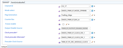

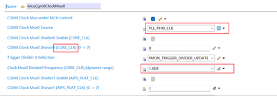

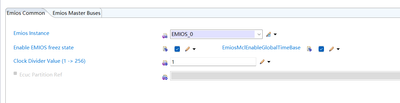

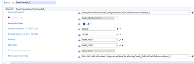

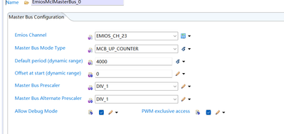

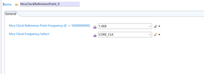

Here is my configuration in EB tresos
clock is 160M
drfrefw123_1-1706250498803.pngdrfrefw123_2-1706250515593.pngdrfrefw123_3-1706250548013.pngdrfrefw123_4-1706250594191.png

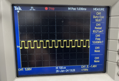

The theoretical result should be:frequency = 160M/4000 = 40k,But the actual result is around 12k

Hi @drfrefw123,
Is the core clock really 160MHz?
Can you check the configuration on the HW or measure it at CLKOUT?
48MHz / 4000 = 12KHz.
CORE_CLK = 48MHz is the default configuration that uses FIRC.

drfrefw123
hi,I have used the PLL clock as the core clock, is there any other configuration?
1,242 Views

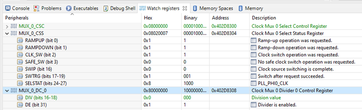

danielmartynek
Can you check the MC_CGM registers to be sure the CORE_CLK is correctly set?
Also, all the clocks should be configured precisely to one of the Options:
RM, rev.8 Section 24.7.2 System clocking configurations.
