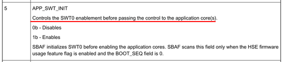

SWT0 is by default disabled.
But this also depends on IVT configuration which you load into uC.

What comes to my mind is watchdog SWT.
Debuggers by default disable watchdog in debug mode, so you can perform debug.
Make sure your SWT is disabled / services correctly.
You can check RGM module DES and FES modules for any latched reset sources.

In the driver settings, I did not add the SWT. Is there a default SWT that gets enabled?
