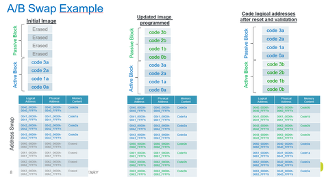

I try to follow the 11.5 Application update (AB_SWAP) chapter of HSE-B Firmware Reference Manual. And I get stuck at the first sentence:  "Programming the new application image in the passive partition".
My question is that: how to program the passive partition from S32 Design studio? All I see in the examples was something like this: Program the active partition -> copy it to the passive -> Request the HSE for active / passive partition swapping -> reset.
Can I directly program the passive partition from  or should I do something like this.:
  1. Switch A-> B
  2. reset
  3. Program B
  4. Switch B -> A
  5. reset
Or should I create a linker file to the passive area and program it?

to prepare the new application in the passive partition you can can directly program the higher address range to which the passive are is mapped to with the new code with the help of an uploader function in your existing application  .  On the K344 it would be addresses 0x0060_0000 onwards. Due to the automatic address translation the passive partition is always mapped to this higher address range , independant which physical block it is.
The method with the linker file is relevant, if you wnt to update for example the AB Swap firmware itself with a new FW image. This can be done by definition of a memory section for the new pink image as shown below.  But his is not relevant when you update the passive area with the new application version.

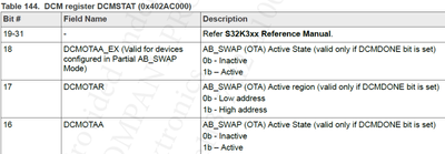

  • It seems to work because if flash my image after a reset the DCMOTAR value of DCMSTAT (0x402AC000) register changed to 1 → 0
  • Before reset:
  • After reset
