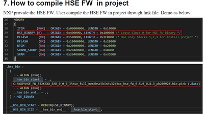

to prepare the new application in the passive partition you can can directly program the higher address range to which the passive are is mapped to with the new code with the help of an uploader function in your existing application  .  On the K344 it would be addresses 0x0060_0000 onwards. Due to the automatic address translation the passive partition is always mapped to this higher address range , independant which physical block it is.
The method with the linker file is relevant, if you wnt to update for example the AB Swap firmware itself with a new FW image. This can be done by definition of a memory section for the new pink image as shown below.  But his is not relevant when you update the passive area with the new application version.
