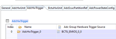

- The Index of Internal trigger of Adc using for Bctu, should go with the correct value of source trigger. This is a bug from driver 2.0.0, when the source trigger not follow the index, but the value of source.
E.g AdcHwTrigger2, with source eMIOS0_4, then the index of it should be 2. But the driver takes the value of source as 4, then the register TRGCFG_[4] be setup, instead of  TRGCFG_[0]
My solution is, using the Index equal with trigger source. For example, the index0 should go with hardware trigger source 0, which is eMIOS0_0

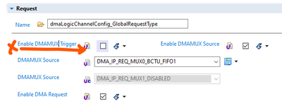

- One last suggestion, in the DMA configuration, due to 2.0.0 the DMA configure is not separate to Rm module, so in this configuration, please pay attention to not Enable the DMAMUX Trigger

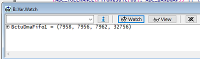

As my test, the Dma raised request isr
and the BctuDmaFifo1 buffer has data in it.
