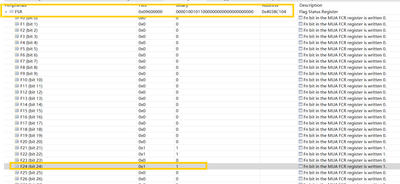

lukaszadrapa
The FSR register looks good, the HSE is obviously up and running. It seems the memory at 0x4039C028 is not displayed correctly. Even if HSE firmware is not installed, the content should be completely different. There should not be just all zeros. You can try to read it by your code via pointer. My guess is that it could be caused by the debugger.

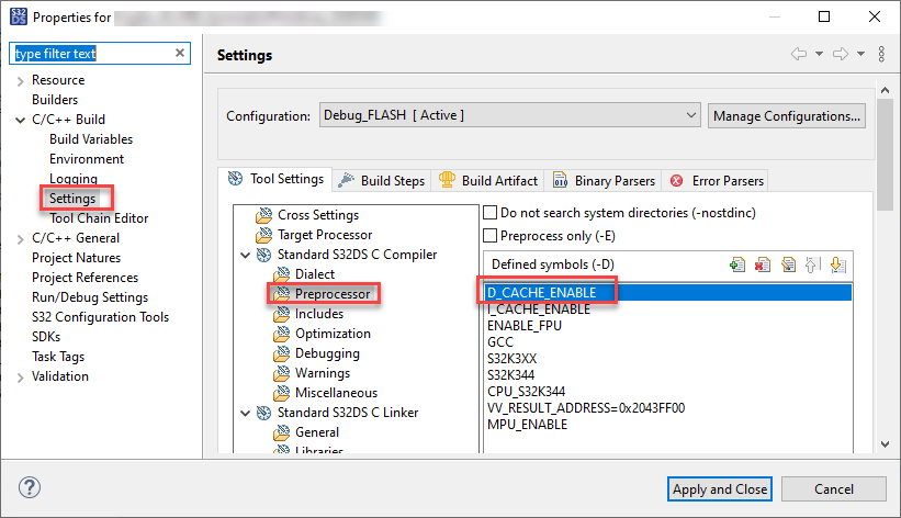

Have you tried to disable data cache completely? Go to project properties and delete D_CACHE_ENABLE:
Does this make a difference?
2,802 Views
lukaszadrapa
It seems the screenshot was not uploaded, so I will attach it here.

I have attached my source file and I have already checked the bit 24 of FSR in MU_0_MUB. it is 1 in bit24 so the code can run and pass the "while(!MU_GetHseStatus())".
but if the function "HSE_GetVersion" is called ,the pc stuck in the function “HSE_Write_Impl” which makes me feel confused.
you mentioned the register "HSE GPR " and I try to browse in the  Peripheral registers by S32DS but I find no such register.

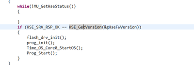

yin_qiu
I did such logical code in the Main function: source code can pass the while ,but stuck in the function  HSE_GetVersion.
I put the Mu descriptor in DTCM and also I put it in no cacheable ram, the result is the same
