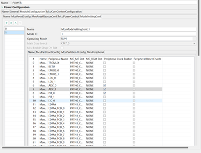

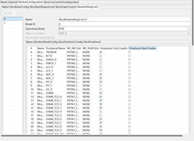

Currently our TBOX developed based on S32K312 needs low power consumption, we plan to use 120MHZ and 750KHZ clocks, where the 750KHZ clock will be used for low power scenarios:
my clock configurations and Power mode configurations are as follows.
1. Very low speed run mode clock config
2. RUN MODE POWER config
3. Very Low speed run mode power config
4. PIN Config
My requirement is how to switch from 120MHZ to 750KHZ or 750KHZ to 120MHZ?

Before switching, do I need to turn off the PIN, LPUART, ADC that are already turned on, and then turn them back on after the clock is switched?
Please help me to confirm the above information, currently my test keeps going to HardFault_Handler。

liangyouchao
My RTD Version is SW32K3_RTD_4_4_2_0_0_D2203.
Now I have solved the problem, I solved it by configuring the FIRC setting FIRC under MCU control to disabled, but didn't understand why FIRC was configured that way.
