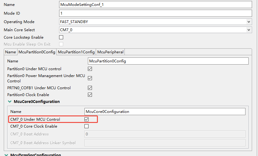

I encountered a problem where the RTI cannot wake up the MCU when I do not check the option CM7_0 Under MCU Control. If it is checked, there will be no problem.
I have searched the manual and code but found no association between the "CM7_0 Under MCU Control" option and the RTI. Moreover, this option does not affect other wake-up sources, such as RTC. What could be the reason?

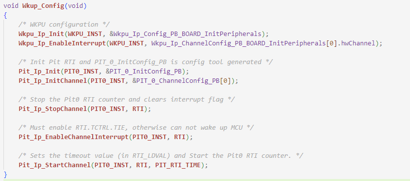

The software version I am using is RTD4.0.0HF02. Below is my configuration code。

I've created a project for low power, where both the SW0 and RTI are configured as wake up sources. I've also disabled "CM7_0 under MCU Control", which does not influence whether the MCU can wake up or not; I've only been unable to wake up if "Partition0 Under MCU control" is disabled, which makes sense, since PRTN0 is needed for RTI configuration.

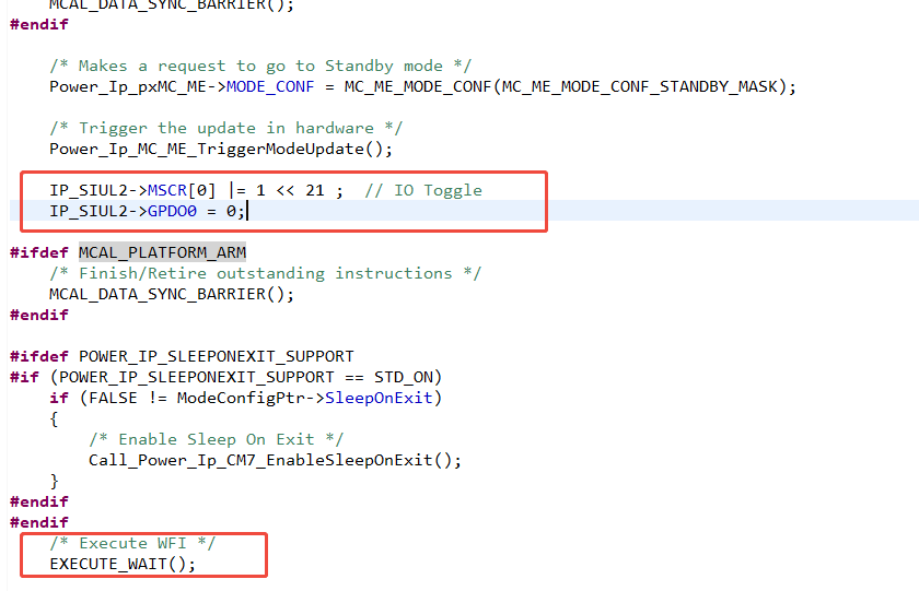

After investigating my own application, I discovered that the time interval between Pit_Ip_StartChannel and EXECUTE_WAIT is 30μs. When I increased this delay to 300μs, the problem was resolved.
Subsequently, I tested your RTD 5.0.0 demo and found the time interval to be 300μs, which means my issue was not reproduced.

The SW team has confirmed that this is a bug in version 4.0.0. The Power_Ip_MC_ME_TriggerPartitionUpdate API does need the timeouts added, but in RTD 4.0.0, user can add timeout check with the CM7_0 Under MCU Control option checked.
Adding the delay or selecting CM7_0 Under MCU Control are the proposed workarounds, for now.

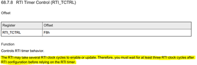

It seems that the root cause is that MCU goes into standby before RTI finishes configurations.
There is this note in S32K3XX RM:
The SW team is working on a fix for this issue.
