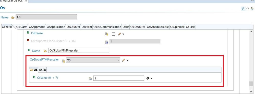

FTM ticks can be calculated as below:
FTM ticks = Prescaler / Input Frequency.
While Prescaler can be chosen in EB tresos:
Prescaler = 2^(OsValue), e.g. OsValue= 2 => Prescaler = 2^2 = 4.
FTM input Frequency is pretty much depended on SystemInit, in the sample application, FTM input Frequency is FIRC: 48MHz.

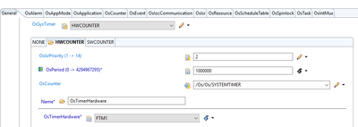

Regarding your description of "FTM input Frequency is pretty much depended on SystemInit...", do you mean that, in this example, FTM0 input Frequency depends on the configuration for FTM0 in MCU Peripheral Clock Frequency?
By the way, it seems only FTM can be used as SystemTimer in HWCOUNTER. Does it means, the System Tick can not serve as the SystemTimer source in NXP Autosar OS? Thanks!
7,275 Views
nxf31947
-> Yes, it will depends on SDK configuration
-> choose System timer as SWCOUNTER and System Tick can serve as the SystemTimer
Because SysTick doesn't support as Hardware counter
7,505 Views
nxf31947
Actually, you can config tick duration( in nanoseconds ) like the picture below:
Sysgen will help you calculate clock divider value automatically
Check the generated output folder and you can see the define OSTICKDURATION
