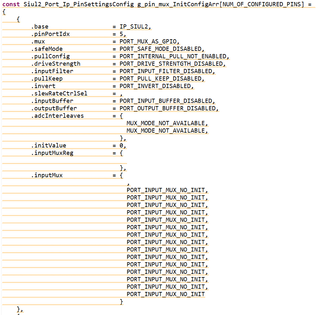

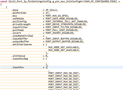

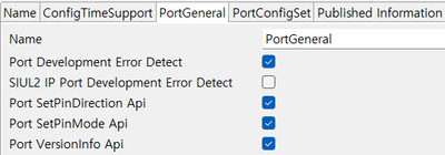

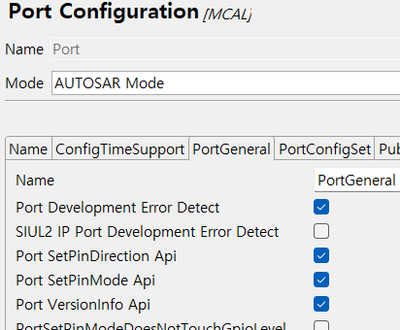

hi,
i have some question about using MCAL Port Module.
in configuration, PortPin Slew Rate be set 0 but in generated code that parts are empty so that build error occured.(and i can't change that)
second,
i enable the Api to change PinMode and PinDirection, but can't call that function.
jwjung_2-1753245304099.pngjwjung_2-1753245304099.pngjwjung_3-1753245385753.pngjwjung_3-1753245385753.png
The gpio output control could not be performed because the direction of the port pin could not be changed.
give me some advise to use the MCAL Port Module.
thank you.

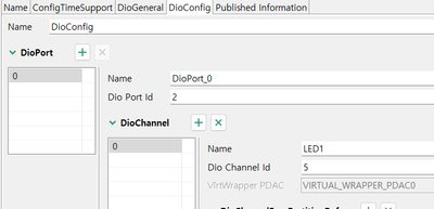

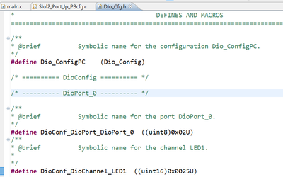

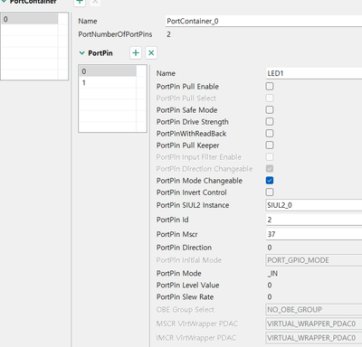

hi
i'm trying to use PTB8 for GPIO port pin. and i named it LED1.
so that i configure the value like this.
picture 1) Port Configuration - PortConfigSet - PortContainer_0
picture 2) Port Configuration - PortGeneral
picutre 3) Dio Configuration - DioConfig
and the PIN_PORT BE generated like this. so that i write the code like below.
so, my question is,
i configure the configuration to use SetPinDirection and setPinMode Api but i can't call the function to use.
and the Port parameter is differ and do not initialize.
how do i have to do solve this error.
