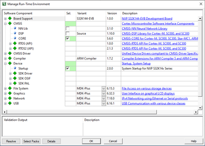

The errors are the same for both of my projects. I did not change anything on the project or files, I only updated the software pack (S32_SDK_DFP 1.5.0). The CORE and startup are enabled in "Manage Run-Time Environment":

… Opening the project and going to Project -> Options For Target ->Asm Tab, the "Assembler" option is set to "armclang (Auto Select)"
